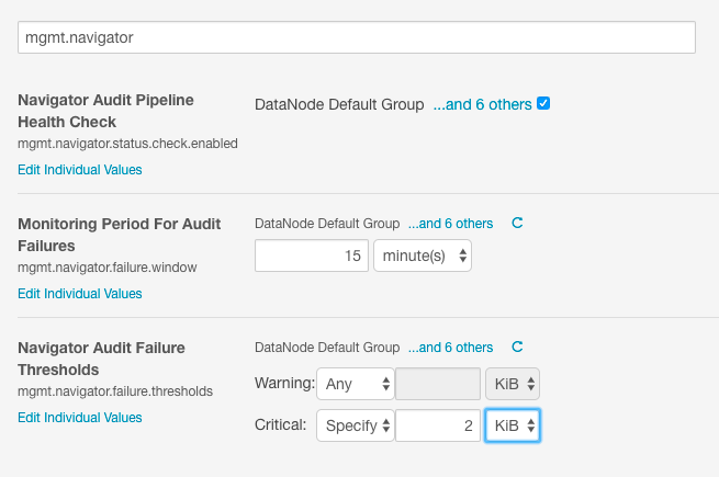

- In the Search field, type mgmt.navigator to display the health check configuration properties for the service:
- Modify the settings to shorten (or lengthen) the monitoring period as needed for your system and set bytes for Warning and Critical thresholds.
Property Description Navigator Audit Pipeline Health Check Check the box to enable the health check. Health check can be enabled for specific groups. By default, the health check is enabled for all groups. Monitoring Period for Audit Failures Default is 20 minutes. The amount of time to process audit events (count processed and evaluate other metrics before generating warnings. Navigator Audit Failure Thresholds Size (in bytes) of failures that will trigger messages. - Warning—Default is Never. Set this to an amount of bytes and condition (which to trigger a warning message.
- Critical—Default is Any, meaning that any amount of failed audit data sent from Cloudera Manager to the server will trigger a critical messagse.
- Click Save Changes.
For example, as shown in the Cloudera Manager Admin Console, the pipeline health check is enabled for all groups in the service. The failure period is set to 15 minutes, and the health check sends a warning for failures of any size and a critical error when 2 KiB of audit events have not been sent.
