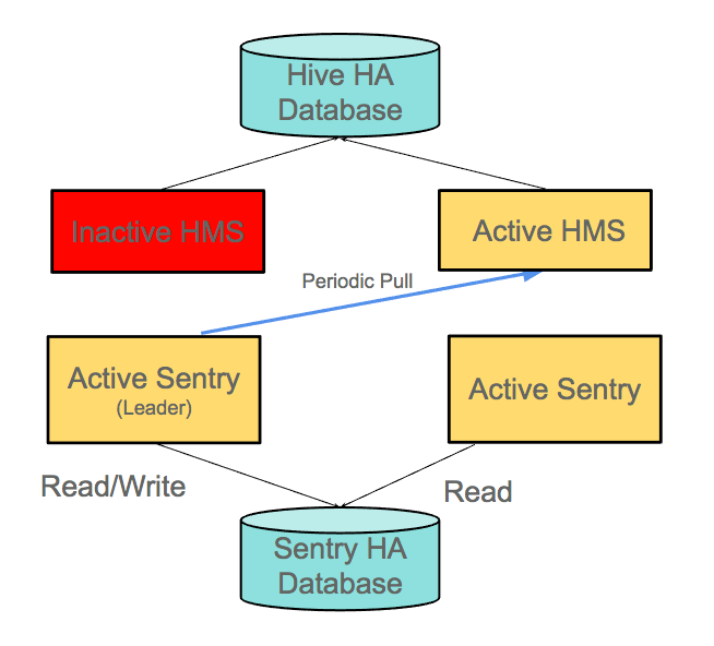

Sentry and Hive Metastore High Availability
You can also use Sentry high availability with Hive metastore high availability. When all the Sentry Servers and Hive metastores are available, the Sentry leader pulls Hive metadata from the Hive metastore master. If one or more is unavailable, the available Sentry Server that is available pulls metadata from the Hive metastore that is available.

When one of the Hive metastores is unavailable, the Sentry leader pulls metadata from the metastore that is available, as the following figure illustrates:
