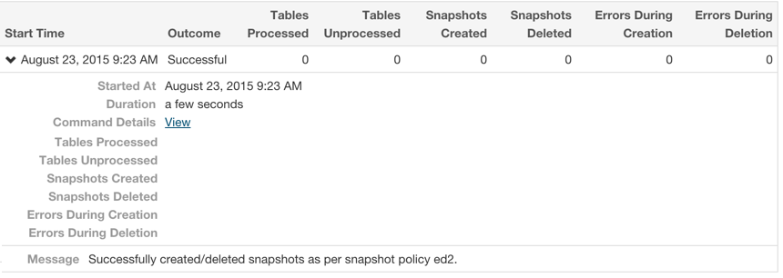

The Snapshots History page displays information about Snapshot jobs that have been run or attempted. The page displays a table of Snapshot jobs with the following columns:
| Column | Description |
| Start Time | Time when the snapshot job started execution.

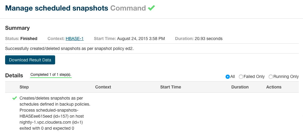

Click ![]() Click the View link to open the Managed scheduled snapshots Command page, which displays details
and messages about each step in the execution of the command. For example:
| Outcome | Displays whether the snapshot succeeded or failed. |
| Paths | Tables Processed |
HDFS snapshots: the number of Paths Processed for the snapshot. HBase snapshots: the number of Tables Processed for the snapshot. |
| Paths | Tables Unprocessed |
HDFS Snapshots: the number of Paths Unprocessed for the snapshot. HBase Snapshots: the number of Tables Unprocessed for the snapshot. |
| Snapshots Created | Number of snapshots created. |
| Snapshots Deleted | Number of snapshots deleted. |
| Errors During Creation | Displays a list of errors that occurred when creating the snapshot. Each error shows the related path and the error message. |

to display details about the snapshot. For example:
