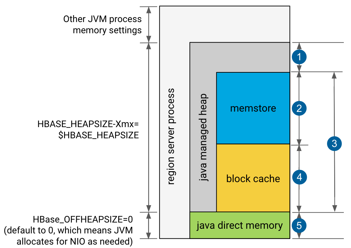

- 20% minimum reserved for operations and rpc call queues
- hbase.regionserver.global.memstore.size: default is 0.4, which means 40%
- hbase.regionserver.global.memstore.size + hfile.block.cache.size ≤0.80, which means 80%
- hfile.block.cache.size: default is 0.4, which means 40%
- slack reserved for HDFS SCR/NIO: number of open HFiles * hbase.dfs.client.read.shortcircuit.buffer.size, where hbase.dfs.client.read.shortcircuit.buffer.size is set to 128k.

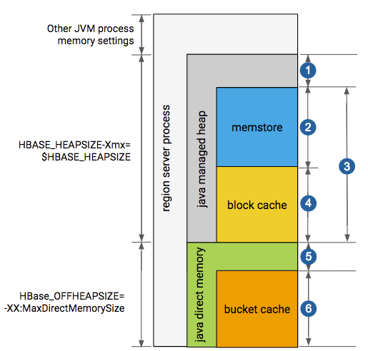

- hfile.block.cache.size: default is 0.4 which means 40%
- hbase.bucketcache.size: default is 0.0
If hbase.bucketcache.size is float <1, it represents the percentage of total heap size.
If hbase.bucketcache.size is ≥1, it represents the absolute value in MB. It must be < HBASE_OFFHEAPSIZE

Use the hbase.bucketcache.ioengine parameter to define where to store the content of the BucketCache. Its value can be offheap, file:PATH, mmap:PATH, pmem:PATH , or it can be empty. By default it is empty which means that BucketCache is disabled.
When hbase.bucketcache.ioengine is set to offheap, the content of the BucketCache is stored off-heap as it is presented on the Default LRUCache, L1 only block cache hbase.bucketcache.ioengine=offheap image.
