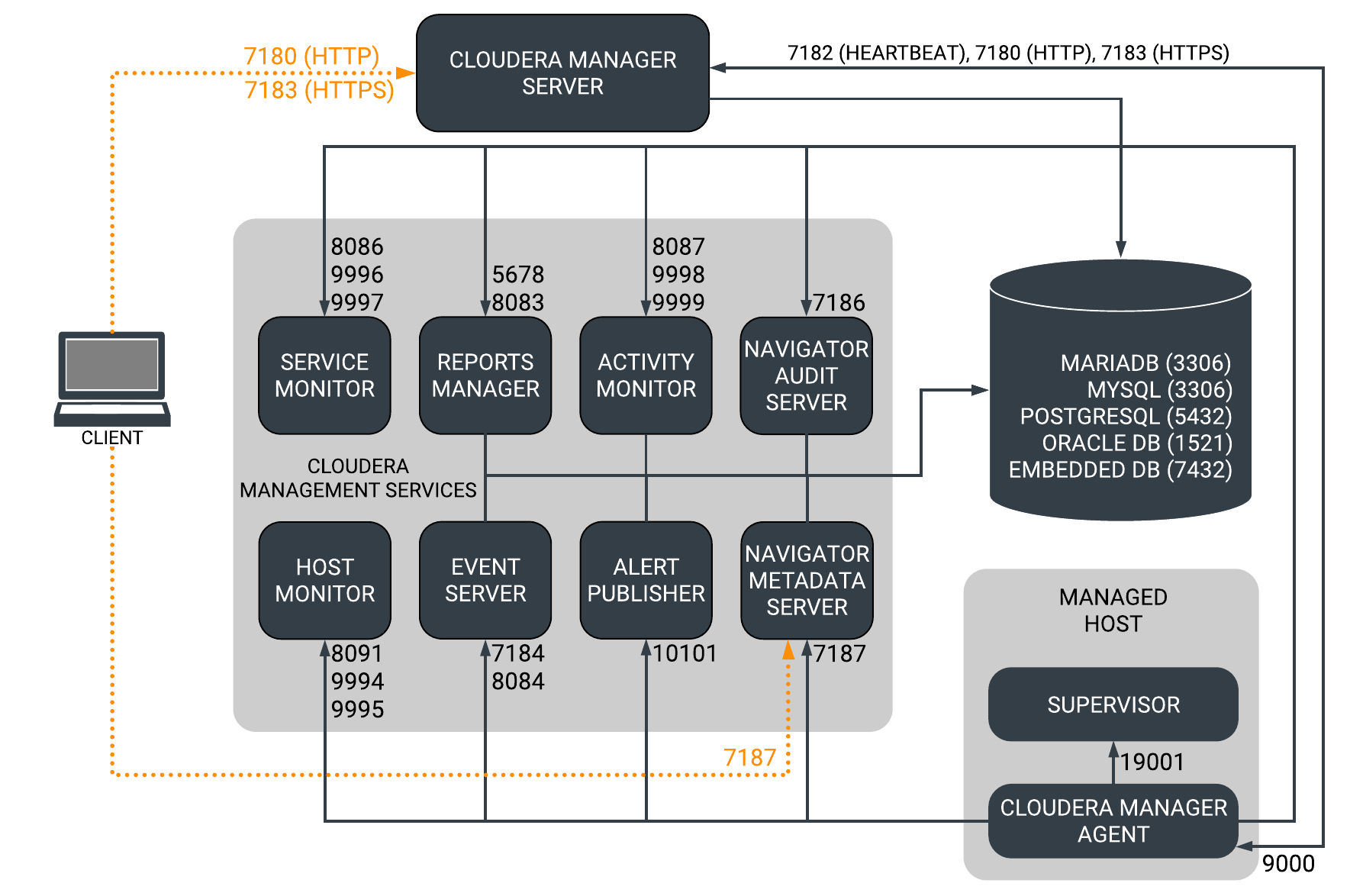

Ports Used by Cloudera Manager and Cloudera Navigator
The following diagram provides an overview of some of the ports used by Cloudera Manager, Cloudera Navigator, and Cloudera Management Service roles:

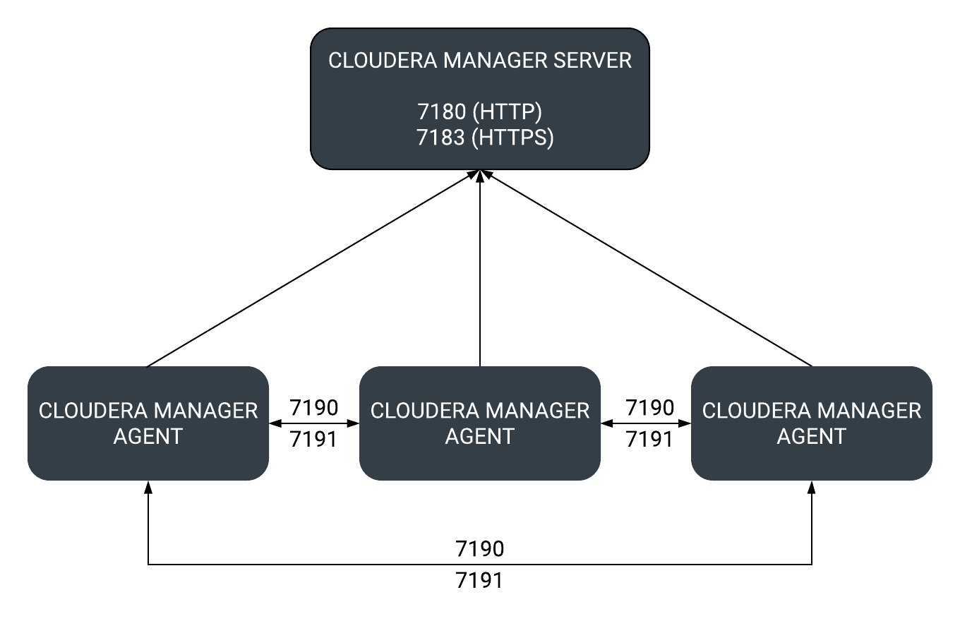

When peer-to-peer distribution is enabled for parcels, the Cloudera Manager Agent can obtain the parcel from the Cloudera Manager Server or from other agents, as follows:
Ports Used in Peer-to-Peer Parcel Distribution
For further details, see the following tables. All ports listed are TCP.
In the following tables, Internal means that the port is used only for communication among the components; External means that the port can be used for either internal or external communication.

| Peer-to-peer parcel distribution | 7190, 7191 | Used to distribute parcels to cluster hosts during installation and upgrade operations. | ||
