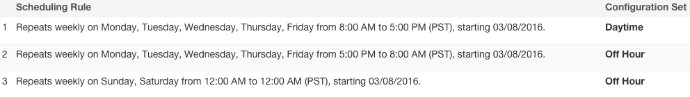

Configuration Sets define the allocation of resources across pools that can be active at a given time. For example, you can define "daytime" and "off hour" configuration sets, for which you specify different resource allocations during the daytime and for the remaining time of the week.
A scheduling rule defines when a configuration set is active. The configurations in the configuration set are propagated to the fair scheduler allocation file as required by the schedule. The updated files are stored in the YARN ResourceManager configuration directory /var/run/cloudera-scm-agent/process/nn-yarn-RESOURCEMANAGER on the host running the ResourceManager role. See Server and Client Configuration.
The resources available for sharing are subject to the allocations made for each service if static service pools (cgroups) are enforced. For example, if the static pool for YARN is 75% of the total cluster resources, resource pools will use only 75% of resources.
After you create or edit dynamic resource pool settings, Refresh Dynamics Resource Pools and Discard Changes buttons display. Click Refresh Dynamics Resource Pools to propagate the settings to the fair scheduler allocation file (by default, fair-scheduler.xml). The updated files are stored in the YARN ResourceManager configuration directory /var/run/cloudera-scm-agent/process/nn-yarn-RESOURCEMANAGER on the host running the ResourceManager role. See Server and Client Configuration.

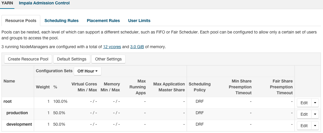

Viewing Dynamic Resource Pool Configuration
- YARN - Weight, Virtual Cores, Min and Max Memory, Max Running Apps, Max Resources for Undeclared Children, and Scheduling Policy
- Impala Admission Control - Max Memory, Max Running Queries, Max Queued Queries, Queue Timeout, Minimum Query Memory Limit, Maximum Query Memory Limit, Clamp MEM_LIMIT Query Option, and Default Query Memory Limit
- Select . If the cluster has a YARN service, the tab displays. If the cluster has an Impala service enabled as described in Enabling or Disabling Impala Admission Control in Cloudera Manager, the tab displays.
- Click the YARN or Impala Admission Control tab.
Creating a YARN Dynamic Resource Pool
There is always a resource pool named root.default. By default, all YARN applications run in this pool. You create additional pools when your workload includes identifiable groups of applications (such as from a particular application, or a particular group within your organization) that have their own requirements.- Select . If the cluster has a YARN service, the tab displays. If the cluster has an Impala service enabled as described in Enabling or Disabling Impala Admission Control in Cloudera Manager, the tab displays.
- Click the YARN tab.
- Click Create Resource Pool. The Create Resource Pool dialog box displays, showing the Resource Limits tab.
- Specify a name and resource limits for the pool:
- In the Resource Pool Name field, specify a unique pool name containing only alphanumeric characters. If referencing a user or group name that contains a ".", replace the "." with "_dot_".
- To make the pool a parent pool, select the Parent Pool checkbox.
- Define a configuration set by assigning values to the listed properties. Specify a weight that indicates that pool's share of resources relative to other pools, minimum and maximum for virtual cores and memory, and a limit on the number of applications that can run simultaneously in the pool. If this is a parent pool, you can also set the maximum resources for undeclared children.
- Click the Scheduling Policy tab and select a policy:
- Dominant Resource Fairness (DRF) (default) - An extension of fair scheduling for more than one resource. DRF determines CPU and memory resource shares based on the availability of those resources and the job requirements.
- Fair (FAIR) - Determines resource shares based on memory.
- First-In, First-Out (FIFO) - Determines resource shares based on when a job was added.
- If you have enabled Fair Scheduler preemption, click the Preemption tab and optionally set a preemption timeout to specify how long a job in this pool must wait before it can preempt resources from jobs in other pools. To enable preemption, follow the procedure in Enabling and Disabling Fair Scheduler Preemption.
- If you have enabled ACLs and specified users or groups, optionally click the Submission and Administration Access Control tabs to specify which users and groups can submit applications and which users can view all and kill applications. By default, anyone can submit, view all, and kill applications. To restrict these permissions, select Allow these users and groups and provide a comma-delimited list of users and groups in the Users and Groups fields respectively.
- Click Create.
- Click Refresh Dynamic Resource Pools.

Example Configuration Sets
The Daytime configuration set assigns the production pool five times the resources of the development pool:
The Off Hour configuration set assigns the production and development pools an equal amount of resources:
See example scheduling rules for these configuration sets.
- In the Configuration Sets drop-down list, select a configuration set. The properties of each pool for that configuration set display.
Scheduling Configuration Sets
Example Scheduling Rules
Consider the example Daytime and Off Hour configuration sets. To specify that the Daytime configuration set is active every weekday from 8:00 a.m. to 5:00 p.m. and the Off Hour configuration set is active all other times (evenings and weekends), define the following rules:
Adding a Scheduling Rule
- Click the Scheduling Rules tab.
- Click Create Scheduling Rule.
- In the Configuration Set field, choose the configuration set to which the rule applies. Select Create New or Use Existing.
- If you create a new configuration set, type a name in the Name field.
If you use an existing configuration set, select one from the drop-down list.
- Configure the rule to repeat or not:
- To repeat the rule, keep the Repeat field selected and specify the repeat frequency. If the frequency is weekly, specify the repeat day or days.
- If the rule does not repeat, clear the Repeat field, click the left side of the on field to display a drop-down calendar where you set the starting date and time. When you specify the date and time, a default time window of two hours is set in the right side of the on field. Click the right side to adjust the date and time.
- Click Create.
