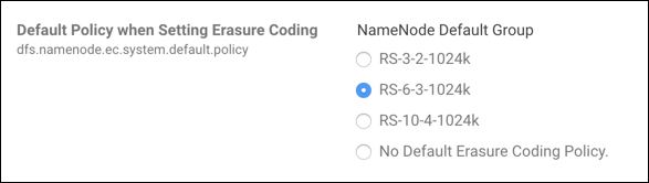

Using Erasure Coding Policies with Hive
Erasure Coding (EC) policies determine how your data is encoded and decoded—it defines how your data is sliced. The default policy of EC is RS-6-3-1024k, let's look at this in more detail:
- RS — The Codec
Specifies the codec used for encoding and decoding. RS represents Reed Solomon. This is the only supported codec type at this time.
- 6 — Number of data cells
Sets how many pieces (data cells) your data is sliced into. In this example, there are six data cells in each stripe.
- 3 — Number of parity cells
Sets how many parity cells are calculated and stored. Parity cells are used for data resilience. When data loss or corruption occurs, the parity cells are used to decode and reconstruct the lost data. In this example, there are three parity cells in each stripe.
- 1024k — Size of each cell
The size of one unit of striped data.

Activating Erasure Coding on a New Hive Table
Erasure Coding activates when you set an EC policy on your Hive table. After you set the policy, all the data you input from then on is erasure-coded. Use this method on new Hive tables (empty of data), or tables where you want existing data to remain replicated and new data to be erasure-coded.
Use the command line to activate EC on a new Hive table:
bash> hdfs ec -setPolicy -policy RS-3-2-1024k -path <table_location>
To use a different policy, replace RS-3-2-1024k with the policy you want to use.
