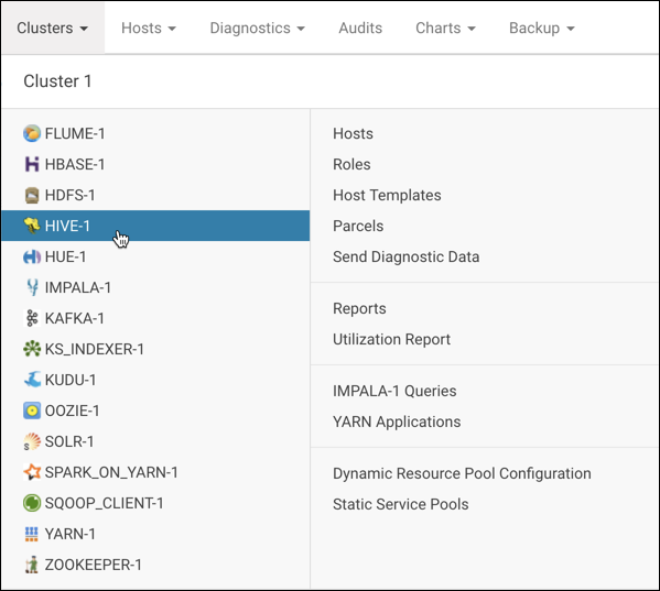

- Click Clusters in the top navigation bar, and choose Hive from the list of service instances.

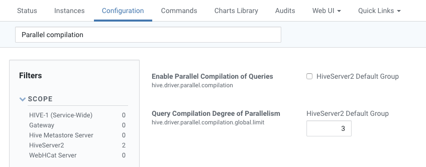

- In the Search field, search for Parallel compilation, the results display two configuration options:
Enable Parallel Compilation of Queries
Select this to turn off the compilation lock and allow parallel compilation.
Query Compilation Degree of Parallelism
This defines the number of workers that can compile queries in parallel. To learn how to set the degree of parallelism, read Fine-Tuning the Degree of Parallelism.
