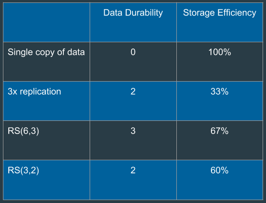

The following image compares the data durability and storage efficiency of different RS codecs and replication:
Storage efficiency is the ratio of data blocks to total blocks as represented by the following formula: data blocks / (data blocks + parity blocks)

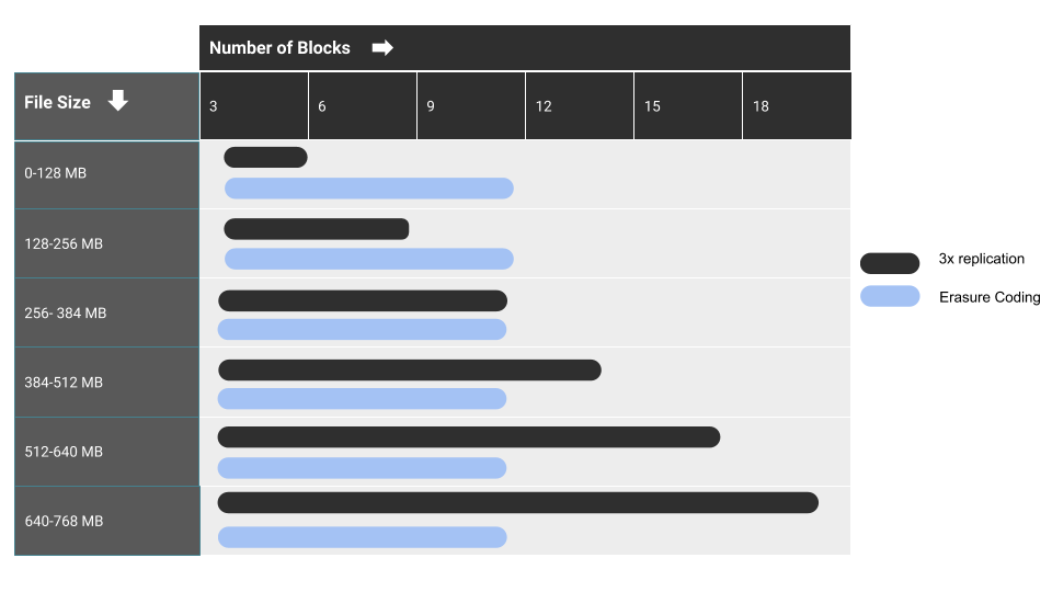

The figure below shows how replication (with a replication factor of 3) compares to EC based on the number of blocks relative to file size. For example, a 128 MB file only requires three blocks because each file fills one block, and three total blocks are needed because of the two additional copies of data that replication maintains. As the file size goes up though, the number of blocks required for data durability with replication goes up.
The number of blocks required for EC remains static up to the 768 MB threshold for RS (6,3).
Comparing 3x Replication and EC Using RS(6,3)
