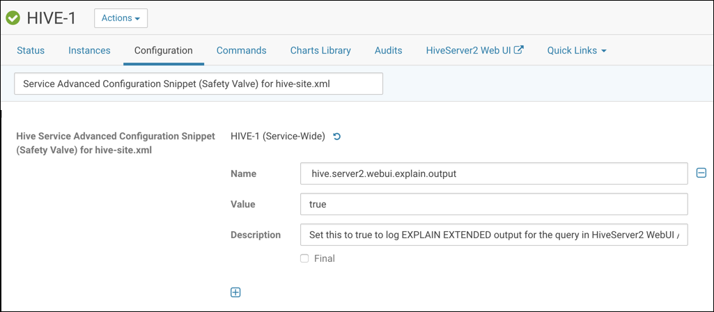

- In the Search field, search for Service Advanced Configuration Snippet (Safety Valve) for hive-site.xml
- Click the plus sign (+), and add the following configurations one at a time to the Service Advanced Configuration Snippet (Safety
Valve):
Name Value Description (optional) hive.server2.webui.explain.output
true
Set this to true to log EXPLAIN EXTENDED output for the query in HiveServer2 WebUI / Drilldown / Query Plan.
hive.server2.webui.show.graph
true
Set this to true to display the Query Plan Graph View instead of text in the WebUI.
hive.server2.webui.max.graph.size
40
The maximum number of stages the Query Plan Graph View can display. Recommended value: 40 (for the best view). Default value: 25.
hive.server2.webui.show.stats
true
Set this to true to display the statistics and log files of MapReduce tasks in the WebUI.
Configuring the Service Advanced Configuration Snippet (Safety Valve)
- Enter a Reason for change, and then click Save Changes to commit the changes.
- After your change is saved, click the restart icon above the Configuration tab.
If you don’t see the reset icon, try refreshing your browser.
- Click Restart Stale Services, and then click Restart Now.
- Click Finish after the restart completes.
