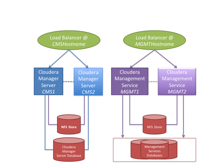

Step 1: Setting Up Hosts and the Load Balancer
At a high level, you set up Cloudera Manager Server and Cloudera Management Service roles (including Cloudera Navigator) on separate hosts, and make sure that network access to those hosts from other Cloudera services and to the Admin Console occurs through the configured load balancer.
Cloudera Manager Server, Cloudera Navigator, and all of the Cloudera Management Service roles that use a relational database should use an external database server, located off-host. You must make sure that these databases are configured to be highly available. See Database High Availability Configuration.
You configure other Cloudera Management Service roles (such as the Service Monitor and Host Monitor roles) that use a file-backed storage mechanism to store their data on a shared NFS storage mechanism.
Creating Hosts for Primary and Secondary Servers
For this example, Cloudera recommends using four hosts for Cloudera Manager services. All of these hosts must resolve forward and reverse DNS lookups correctly:
- Cloudera Manager Server primary host (hostname: CMS1)
- Cloudera Management Service primary host (hostname: MGMT1)
- Cloudera Manager Server secondary host (hostname: CMS2)
- Cloudera Management Service secondary host (hostname: MGMT2)

- Reserve two hostnames in your DNS system, and assign them to each of the load balancer hosts. (The names CMSHostname,
and MGMTHostname are used in this example; substitute the correct hostname for your environment.) These hostnames will be the
externally accessible hostnames for Cloudera Manager Server and Cloudera Management Service. (Alternatively, use one load balancer with separate, resolvable IP addresses—one each to back CMSHostname and MGMTHostname respectively).
- CMSHostname is used to access Cloudera Manager Admin Console.
- MGMTHostname is used for internal access to the Cloudera Management Service from Cloudera Manager Server and Cloudera Manager Agents.

Setting up the Database
- Create databases on your preferred external database server. See Cloudera Manager and Managed Service Data Stores.
- Configure your databases to be highly available. Consult the vendor documentation for specific information.
MySQL, PostgreSQL, and Oracle each have many options for configuring high availability. See Database High Availability Configuration for some external references on configuring high availability for your Cloudera Manager databases.
Setting up an NFS Server
The procedures outlined for setting up the Cloudera Manager Server and Cloudera Management Service hosts presume there is a shared store configured that can be accessed from both the primary and secondary instances of these hosts. This usually requires that this store be accessible over the network, and can be one of a variety of remote storage mechanisms (such as an iSCSI drive, a SAN array, or an NFS server).
This section describes how to configure an NFS server and assumes that you understand how to configure highly available remote storage devices. Further details are beyond the scope and intent of this guide.
