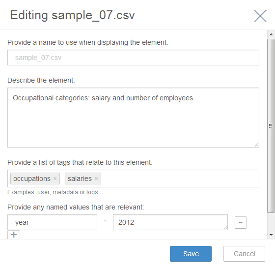

- Click an entity link returned in the search. The metadata pane displays on the left and the lineage page displays on the right.
- In the top-right of the metadata pane, click
. The Editing

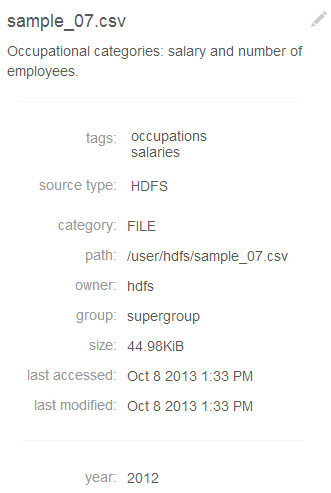

entity dialog box drops down. - Edit any of the fields as instructed. Press Enter or Tab to create new tag entries. For example, a description, the tags
occupations and salaries, and property year with value 2012 have been added to the file sample_07.csv:
You can specify special characters (for example, ".", " ") in the name, but it will make searching for the entity more difficult as some characters collide with special characters in the search syntax. - Click Save. The new metadata appears in the metadata pane:
