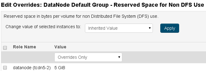

Viewing and Editing Overridden Configuration Properties
To see a list of all role instances that have an override value for a particular configuration setting, go to the entry for the configuration setting in the Status page, expand the Overridden by n instance(s) link in the value cell for the overridden value.
To view the override values, and change them if appropriate, click the Edit Overrides link. This opens the Edit Overrides page, and lists the role instances that have override properties for the selected configuration setting.
On the Edit Overrides page, you can do any of the following:
- View the list of role instances that have overridden the value specified in the role group. Use the selections on the drop-down menu below the Value column header to view a list of instances that use the inherited value, instances that use an override value, or all instances. This view is especially useful for finding inconsistent properties in a cluster. You can also use the Host and Rack text boxes to filter the list.
- Change the override value for the role instances to the inherited value from the associated role group. To do so, select the role instances you want to change, choose Inherited Value from the drop-down menu next to Change value of selected instances to and click Apply.
- Change the override value for the role instances to a different value. To do so, select the role instances you want to change, choose Other from the drop-down menu next to Change value of selected instances to. Enter the new value in the text box and then click Apply.
