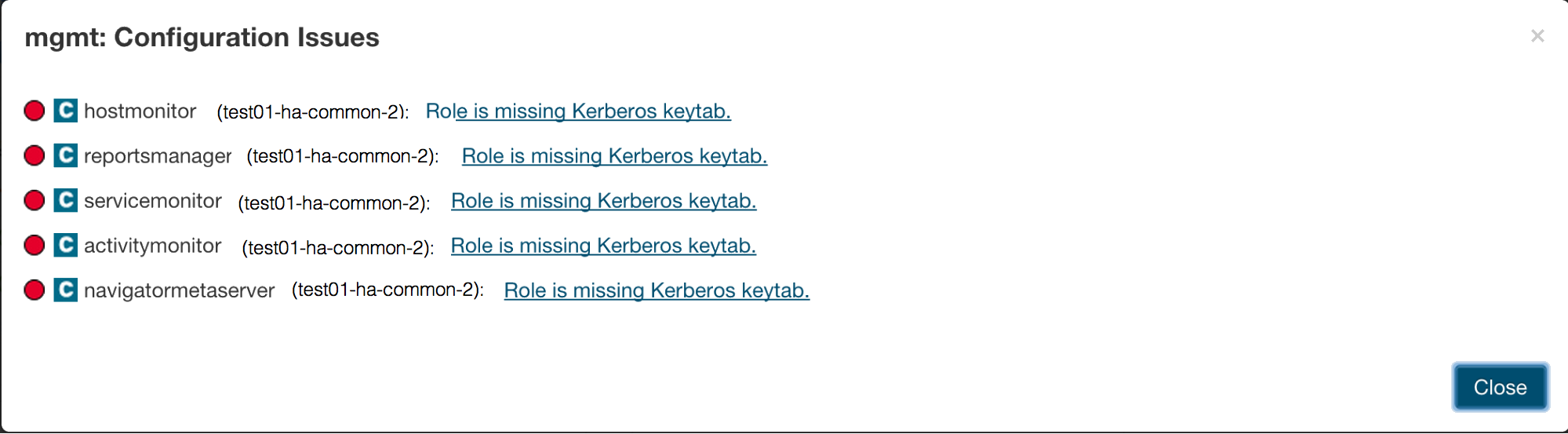

- If you add the Cloudera Management Service to an existing installation using Kerberos authentication (as you do in the Installing the Primary procedure), your Cloudera Management Service could fail to start and displays following message:
This message is expected, and can be corrected by generating Kerberos credentials for these roles using the Cloudera Manager Admin Console. Select .
