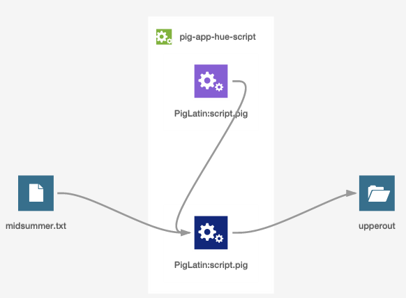

Parent entities are represented by a white box enclosing other entities. The following lineage diagram illustrates the relations between the YARN job script.pig and Pig script script.pig invoked by the parent Oozie workflow pig-app-hue-script and its source file
midsummer.txt and destination folder upperout:

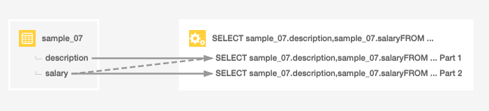

- A solid line (
) represents a "data flow" relationship, indicating that the columns will appear
(possibly transformed) in the output. For example, a solid line will appear between the columns used in a select clause. - A dashed line (
) represents a "control flow" relationship, indicating that the columns
determine which rows will flow to the output. For example, a dashed line will appear between the columns used in an insert or select
clause and the where clause of a Hive query.
SELECT sample_07.description,sample_07.salary FROM sample_07 WHERE ( sample_07.salary > 100000) ORDER BY sample_07.salary DESC LIMIT 1000has solid lines between the columns in the select clause and a dashed line between the columns in the where clause:

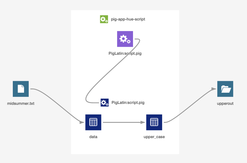

You can click a parent entity to display its child entities. For example, you can click the Pig script to display its child tables:
- To improve the layout of a lineage diagram you can drag and drop entities (in this case midsummer.txt and upperout) located outside a parent box.

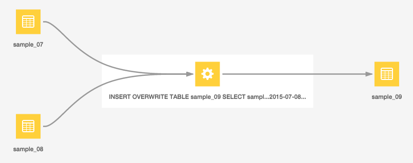

A template lineage diagram contains template entities, such as jobs and queries, that can be instantiated, and the input and output entities to which they are related.

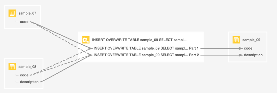

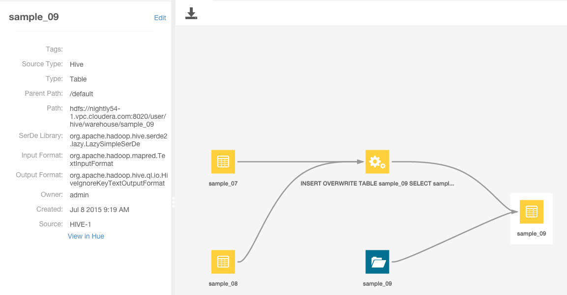

- In the list of results, click an Operation or Query result entry. For example, when you click the sample_09 result entry:
the Search screen is replaced with a page that displays the entity property sheet on the left and lineage diagram on the right:
When you click each entity icon, columns and lines connecting the source and destination columns display:

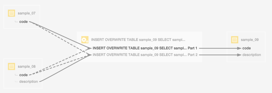

If you hover over a part, the source and destination columns are highlighted:

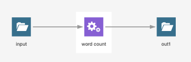

To display an instance lineage diagram:- Display a template lineage diagram. For example:
- Click the Instances tab, which contains a list of links to instances of the template.

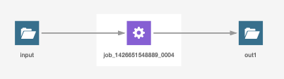

- Click a link to display an instance lineage diagram. For the preceding template diagram, the job instance job_1426651548889_0004 replaces the
word count job template.
