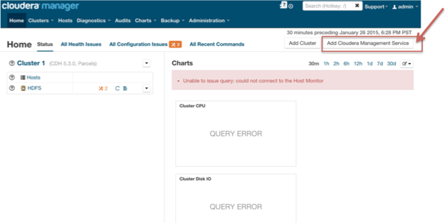

- Connect to the Cloudera Manager Admin Console running on <CMSHostname> and:
- Go to the Hosts tab and make sure that a host with name <MGMTHostname> is reported. (If it is not available yet, wait for it to show up before you proceed.)
- Click Add Cloudera Management Service.

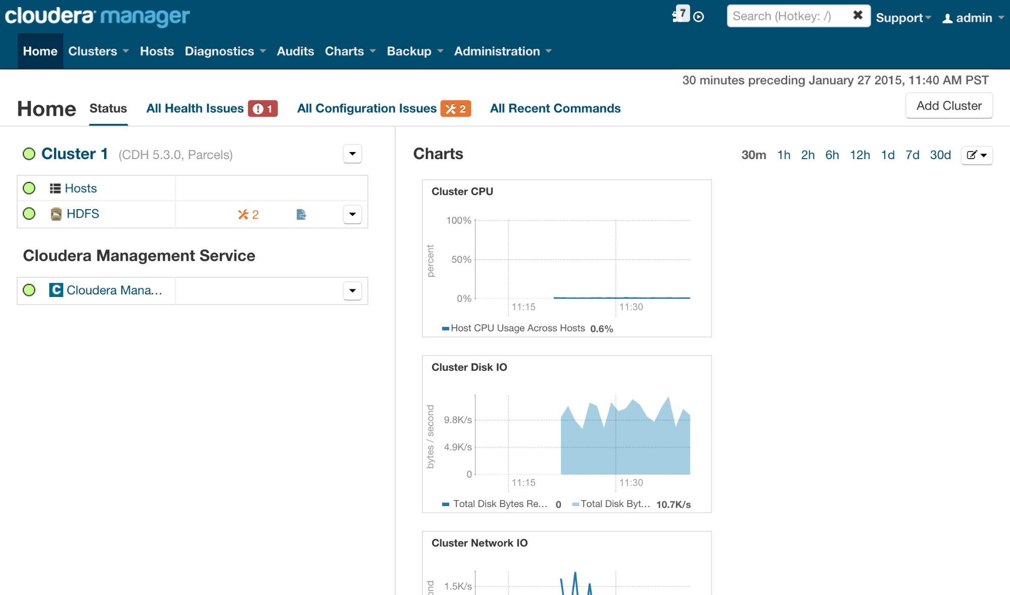

- After you have completed the steps, wait for the Cloudera Management Service to finish starting, and verify the health status of your clusters as well as the health of the Cloudera
Management Service as reported in the Cloudera Manager Admin Console. The health status indicators should be green, as shown:

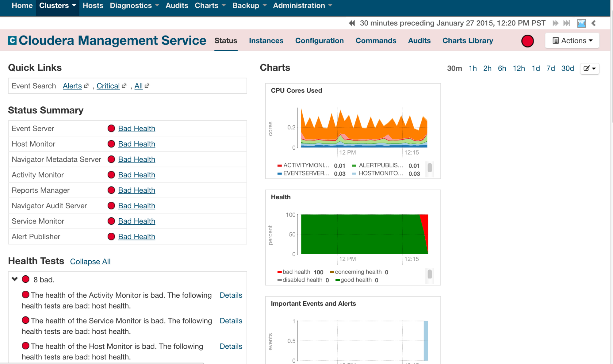

The service health for Cloudera Management Service might, however, show as red:

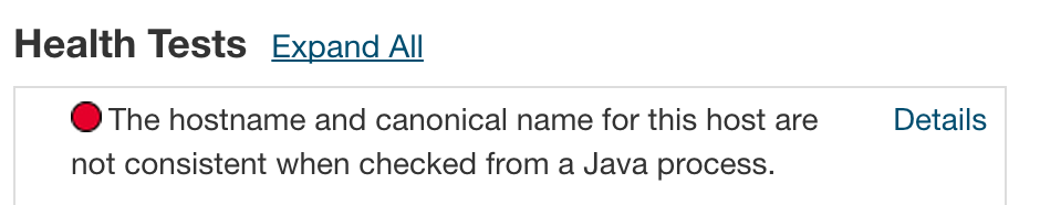

In this case, you need to identify whether the health test failure is caused by the Hostname and Canonical Name Health Check for the MGMTHostname host, which might look like this:
This test can fail in this way because of the way you modified /etc/hosts on MGMT1 and MGMT2 to allow the resolution of MGMTHostname locally. This test can be safely disabled on the MGMTHostname host from the Cloudera Manager Admin Console.
