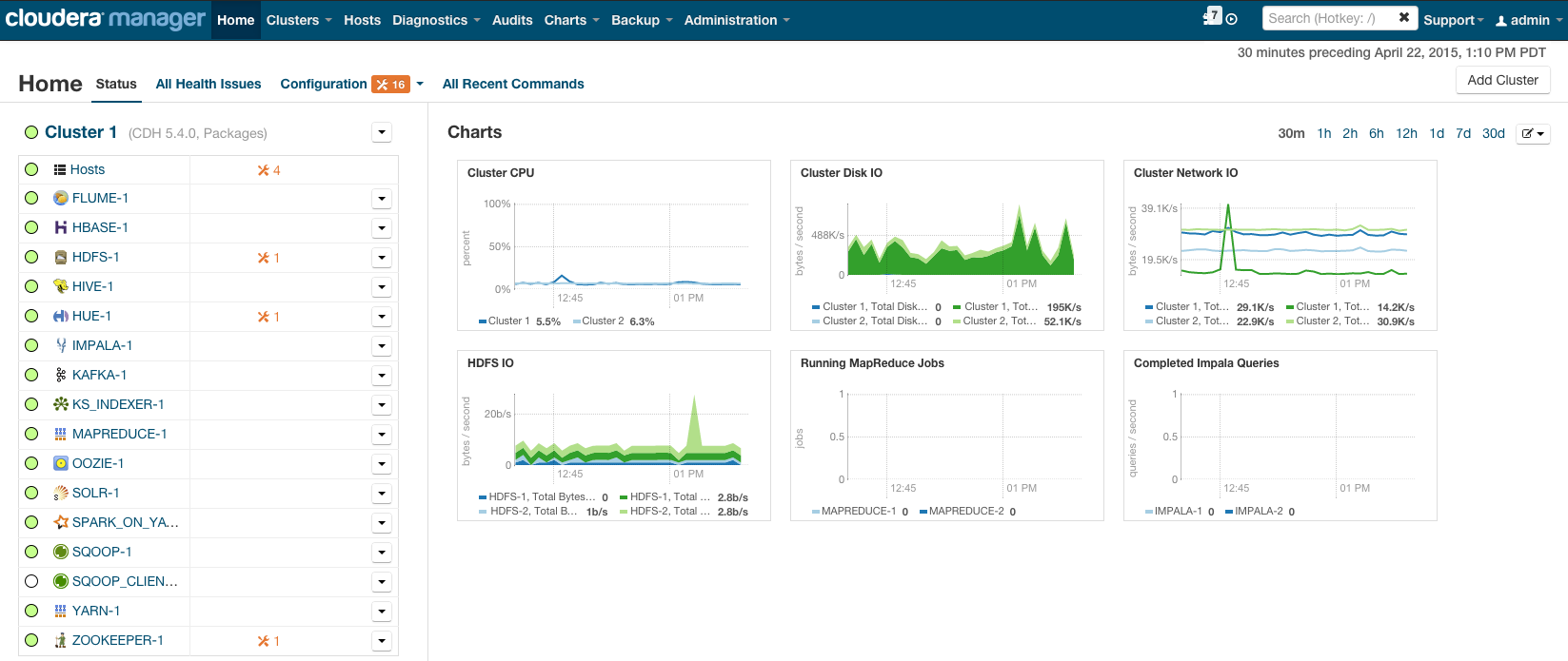

The Home page looks something like this:
On the left side of the screen is a list of services currently running with their status information. All the services should be running with Good Health
, however there may be a small number of configuration warnings
indicated by a wrench icon and a number
, which you can ignore.
You can click each service to view more detailed information about the service. You can also test your installation by running a MapReduce job or interacting with the cluster with a Hue application.

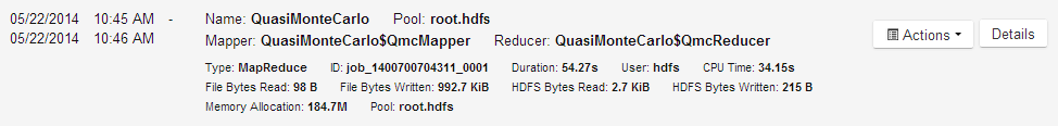

Running a MapReduce Job
- Log into a cluster host.
- Run the Hadoop PiEstimator example:
sudo -u hdfs hadoop jar \ /opt/cloudera/parcels/CDH/lib/hadoop-mapreduce/hadoop-mapreduce-examples.jar \ pi 10 100
- View the result of running the job by selecting the following from the top navigation bar in the Cloudera Manager Admin Console: . You
will see an entry like the following:
