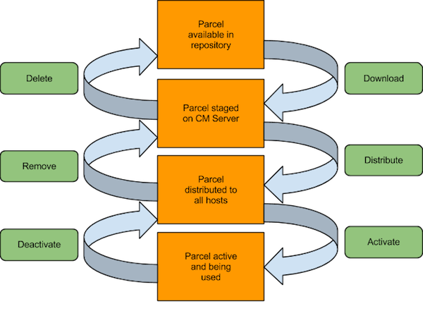

Parcel Life Cycle
- Downloading a parcel copies the appropriate software to a local parcel repository on the Cloudera Manager Server, where it is available for distribution to the other hosts in any of your clusters managed by this Cloudera Manager Server. You can have multiple parcels for a given product downloaded to your Cloudera Manager Server. Once a parcel has been downloaded to the Server, it will be available for distribution on all clusters managed by the Server. A downloaded parcel will appear in the cluster-specific section for every cluster managed by this Cloudera Manager Server.
- Distributing a parcel copies the parcel to the member hosts of a cluster. Distributing a parcel does not actually upgrade the components running on your cluster; the current services continue to run unchanged. You can have multiple parcels distributed on your cluster.
- Unpacking a parcel extracts the files contained in the parcel archive file.
- Activating a parcel causes the Cloudera Manager to link to the new components, ready to run the new version upon the next restart. Activation does not automatically stop the current services or perform a restart — you have the option to restart the service(s) after activation, or you can allow the system administrator to determine the appropriate time to perform those operations.
- Deactivating a parcel causes Cloudera Manager to unlink from the parcel components. A parcel cannot be deactivated while it is still in use on one or more hosts.
- Removing a parcel causes Cloudera Manager to remove the parcel components from the hosts.
- Deleting a parcel causes Cloudera Manager to remove the parcel components from the local parcel repository.

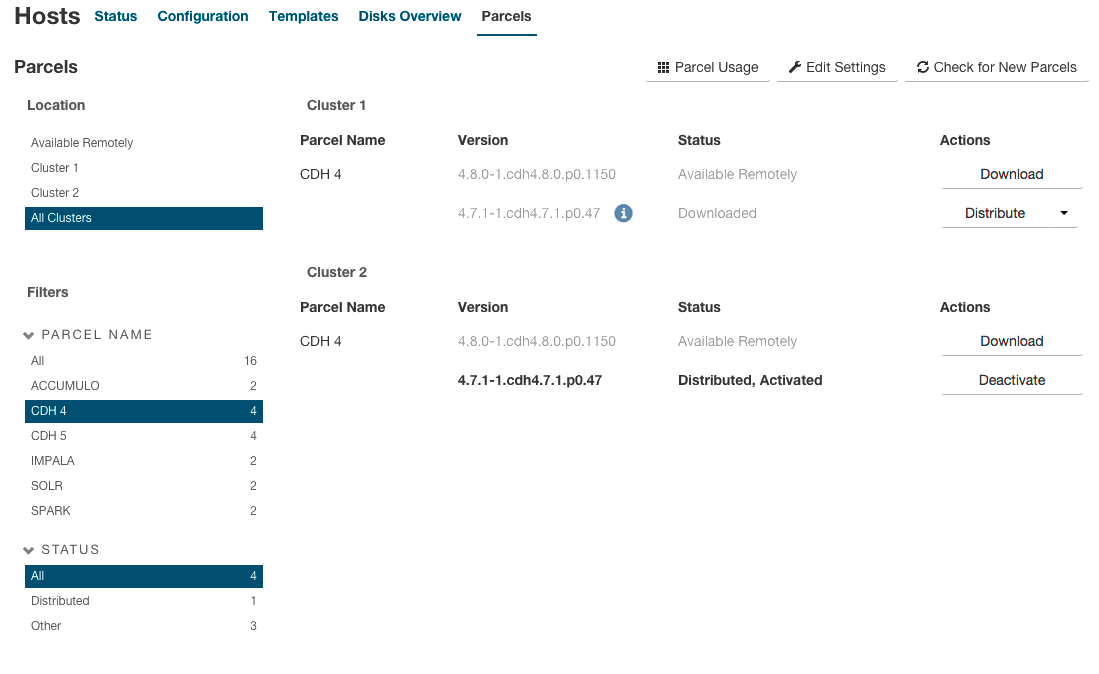

Through the Parcels page in Cloudera Manager, you can manage parcel installation and activation and determine what parcel versions are running across your clusters. The Parcels page displays a list of parcels managed by Cloudera Manager. Cloudera Manager displays the name, version, and status of each parcel and provides actions on the parcel.
Accessing the Parcels Page
- Clicking the parcel indicator in the Admin Console navigation bar (
) - Clicking the Hosts in the top navigation bar, then the Parcels tab.
Use the selectors on the left side of the console to filter the displayed parcels in the following ways:
- Location selector - view only parcels that are available remotely, only parcels pertaining to a particular cluster, or parcels pertaining to all clusters. When you access the Parcels page, the selector is set to Available Remotely.
- Error Status section of the Filters selector - limit the list of displayed parcels by whether error status.
- Parcel Name section of the Filters selector - limit the list of displayed parcels by parcel name.
- Status section of the Filters selector - limit the list to parcels that have been distributed, parcels that have not been distributed (Other), or all parcels.
When you download a parcel, it appears in the list for each cluster managed by Cloudera Manager, indicating that the parcel is available for distribution on those clusters. There is only one copy of the downloaded parcel, residing on the Cloudera Manager Server. After you distribute the parcel, Cloudera Manager copies the parcel to the hosts in that cluster.
For example, if Cloudera Manager is managing two clusters, the rows in the All Clusters page list the information about the parcels on the two clusters. The Status column displays the
current status of the parcels. The Version column displays version information about the parcel. Click the
icon to view the release notes for the parcel. The Actions column contains buttons you can click to perform actions on the parcels such as download, distribute, delete, deactivate, and remove from
host.

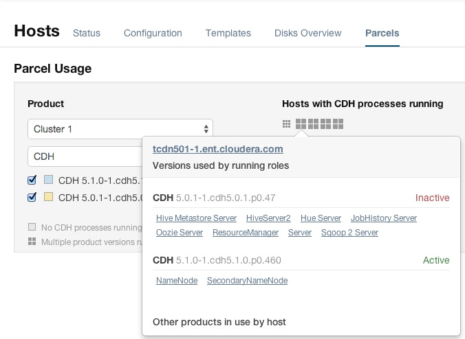

Viewing Parcel Usage
- Do one of the following:
- Click
in the top navigation bar - Click Hosts in the top navigation bar and click the Parcels tab.
- Click
- Click the Parcel Usage button.
This page only shows the usage of parcels, not components that were installed as packages. If you select a cluster running packages (for example, a CDH 4 cluster) the cluster is not displayed, and instead you will see a message indicating the cluster is not running parcels. If you have individual hosts running components installed as packages, they will appear as "empty."
You can view parcel usage by cluster, or by product.
You can also view just the hosts running only the active parcels, or just hosts running older parcels (not the currently active parcels) or both.
The "host map" at the right shows each host in the cluster with the status of the parcels on that host. If the host is actually running the processes from the currently activated parcels, the host is indicated in blue. A black square indicates that a parcel has been activated, but that all the running processes are from an earlier version of the software. This can happen, for example, if you have not restarted a service or role after activating a new parcel.
Move the cursor over the
icon to see the rack to which the hosts are assigned. Hosts on
different racks are displayed in separate rows.
To view the exact versions of the software running on a given host, you can click on the square representing the host. This pops up a display showing the parcel versions installed on that host.
For CDH 4.4, Impala 1.1.1, and Solr 0.9.3 or later, it will list the roles running on the selected host that are part of the listed parcel. Clicking a role takes you to the Cloudera Manager page for that role. It also shows whether the parcel is Active or not.
If a host is running a mix of software versions, the square representing the host is shown by a four-square icon
. When you move the cursor over that host, both the active and inactive components are shown. For example, in the image below the older CDH parcel has been
deactivated but only the HDFS service has been restarted.
