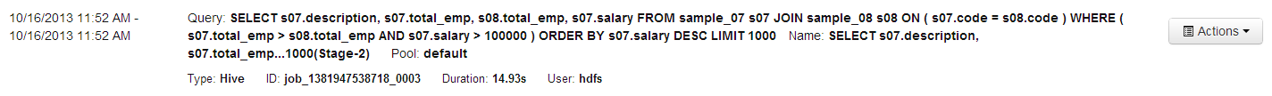

Jobs are ordered with the most recent at the top. Each job has summary and detail information. A job summary includes the following attributes: start and end timestamps, query (if the
job is part of a Hive query) name, queue, job type, job ID, and user. For example:
You can add additional attributes to the summary with the Attribute Selector. To display information about job attributes and possible values, hover over a field in an entry. For example:
