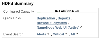

- The HDFS Summary shows disk space usage.

For example:
