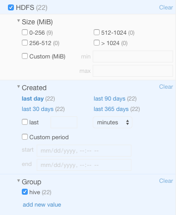

When you select a specific source type value, additional properties that apply to that source type display. For example, HDFS has size, created, and group properties:
The number in parentheses (facet count) after a property value is the number of extracted entities that have that property value:
Facet values with the count of 0 are not displayed.
